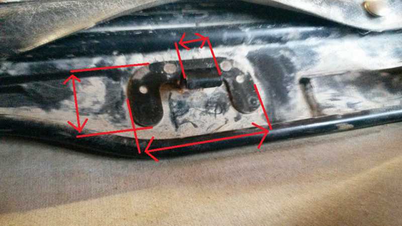

i im in need of some measurements from a soft-top. need a couple measurements from the clips in side if possible one in photo lost my template for make these and have no soft top to work from
help would be most appreciated

could do with them before but if you could just incase no one else replys, I need to make some by Monday the latest
or give me the sizes of the bracket I sent you same thing im going to be making. annoying thing is I throw away my old sort top couple weeks ago

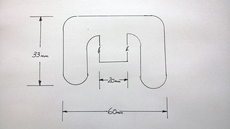

As requested .

Thanks for that saved me loads of hassle. You got the roof fitted yet
