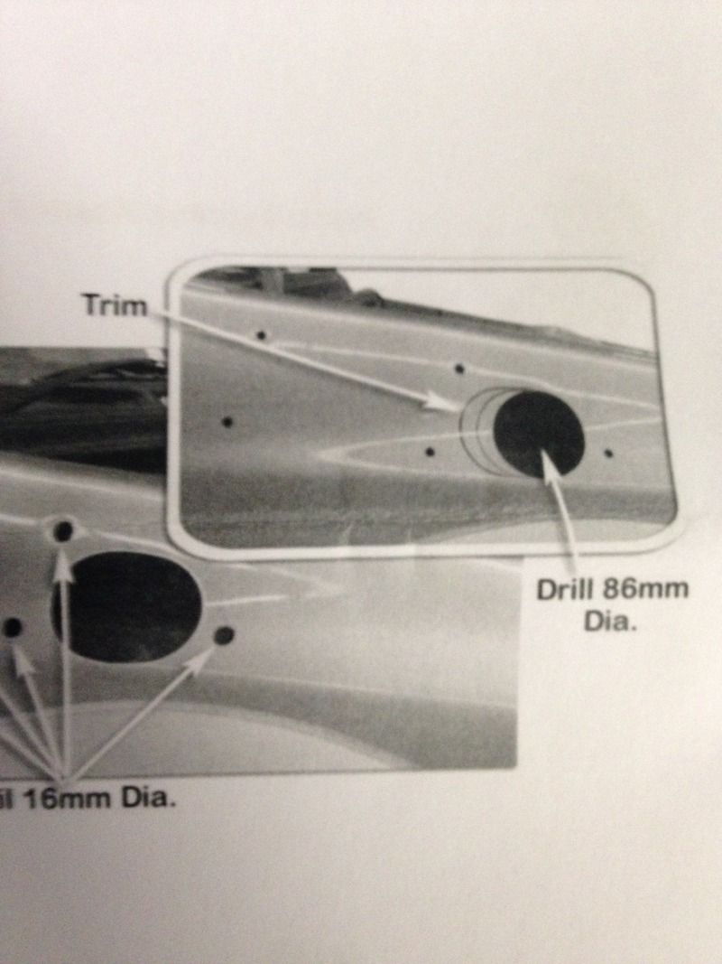

Making hole for safari snorkel
- Lozi
23 May 2015 12:00 #144705
by Lozi
Making hole for safari snorkel was created by Lozi
- suzukisam
23 May 2015 13:50 #144706
by suzukisam
Replied by suzukisam on topic Making hole for safari snorkel
Drill a 15mm hole then get a hacksaw blade on its own and tape one end up so its like a handle . Takes a while but works . I used a hole saw on mine . You could use a hole saw then extend it using a blade.

Replied by Rhinoman on topic Making hole for safari snorkel
On my Vit I chain drilled and then filed.

Replied by Brave on topic Making hole for safari snorkel
What rhinoman said

by Basketcase
Replied by Basketcase on topic Making hole for safari snorkel
I drilled a circle of small holes with a drill bit then hack sawed through and filed it down, can't see it behind the snorkel anyway
