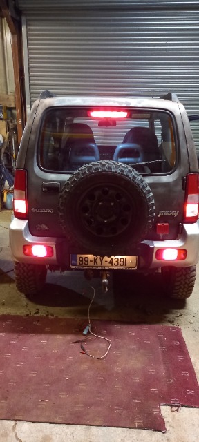

Ok I had previously done the modification where you bring the indicators up out of the bumper and into the rear lights up either side of the rear door .
Ive been pulling the trailer last couple of weeks with no lights and said I wire em in today while I waiting on the crank pulley to arrive .
So got it taped in this evening and got my reg plate lights running again.
The question is do I need to make two connections into the RED/YELLOW STRIPE wire to get left sidelights and right sidelights or can i make just one connection on the RED/YELLOW STRIPE. Thanks in advance lads . J
Brake Lights
Brake Lights

From memory I have mine fed independently from each side.
