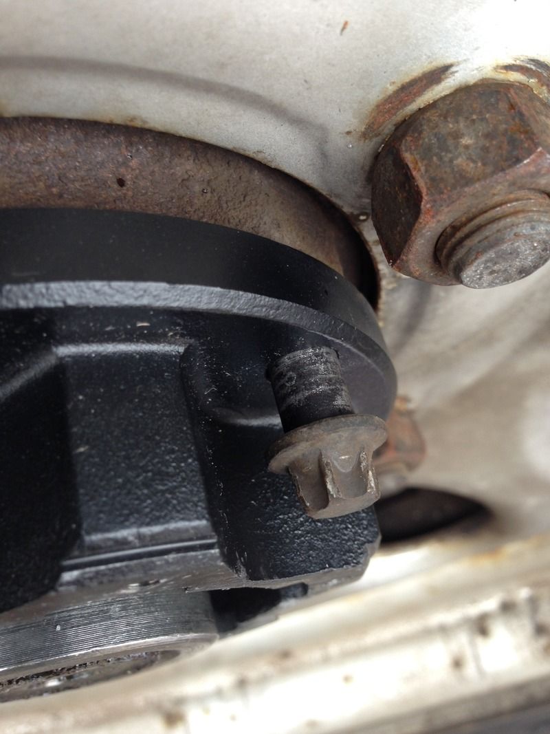

28 Mar 2015 13:59 #141528
by Lozi
Fitting AVM manual hubs was created by Lozi

Replied by GuardianAngel on topic Fitting AVM manual hubs
Where they meant to come with spacers?

Not that I know of there is no mention of spacers in the instructions, I have used some other fixings I have and they seem to work but it is abit worrying to be honest to think there may be something missing.

Replied by Lorry on topic Fitting AVM manual hubs
You need the spacers.

Replied by j999pre on topic Fitting AVM manual hubs
Avm jimny manual hubs don't need spacers. They should come with new bolts, Allen head ones from memory.
Are they definitely avm brand and for a Jimny or have you got sj hubs? In which case you do need spacers and bolts with cone washers.
