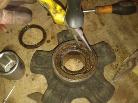

repair the front wheel bearing was created by Mario

i think u got a bit to much cv grease in there

Hello, according to the suzuki Service Manual add only 150 grams of grease per side
Amount shown in the picture
