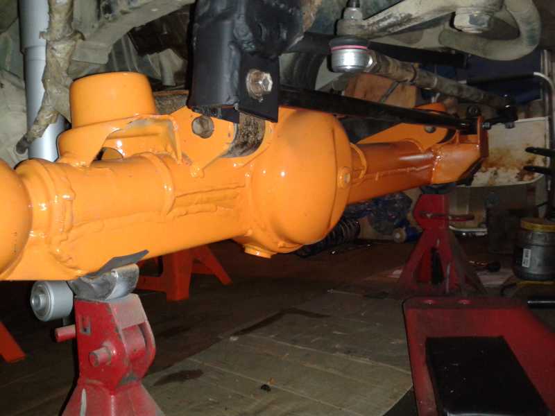

You could just over turn steering rod from bottom to top. For such mod you need one steering rod end of Mitsubishi Pajero or L200. It has same thread pattern as Jimny's rod ends and bigger cone part. Also you need to modify a bit your left steering knuckle (for RHD and right knuckle for LHD). You need to cut hole for MMC rod end in opposite direction.
Look at photo and you will see.
Both rods are perfectly parallel and almost at level. This Jimny has 4" suspension lift.

Thanks Nicks_jim. The panhard is easy enough to lower however lowering the steering rod and staying road legal is a bit trickier. On my old sierra(samurai) I just used a dropped pitman arm and am hoping that there is one available for a jimny.
Green, that is the result I am after. Nice flat arms, that thing would drive like stock however I can't use the same method to lower the steering arm.
