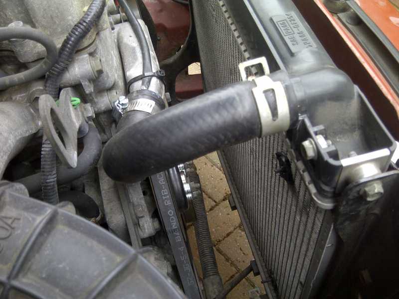

electric fan kit fitted to jimny was created by 410shotgun

what fan is it mate and is the sensor that wire going in the hose

at what temp should it kick in on these dohc jimny

Looks good, what's it like with bits of mud flicking in there and stuff though?

I got it off e bay yes the thermostat wire is that in the top hose and runs up the n/s of the engine and put a cover over the wire the thermostat is inside the car behind the glove box
this was the kit 14" Electric Radiator 12v Cooling Fan With Thermostat For CLASSIC CAR / KIT CAR
I set the thermostat around 85 / 90 and is working ok but you could play around with it
I was going to put a switch inside to over ride the thermostat but not got round to it
when you take the old fan off you need o put some washers on the water pump studs to make up the gap
in the thread . I put a live feed to the fan from the battery but the fan would run after I had switched the engine off so put it so only live when the engine is running . the earth wire is on the thermostat switch

I would say its better as its not running all the time only when its needed
