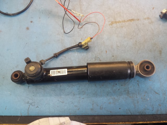

I took some measurements from the one that I have:
Extended length 16.25"
Compressed length 11"
I haven't yet removed one of my shocks for a comparison but the Astra shocks seem quite soft. I ran some current through the actuator and they appeared to get softer, as a simple test I measured the time it took the shock to fully extend from fully compressed, with no current it took 27 secs and with 0.5A it took 18 secs.

This is the shock that I got:
This one seems to be a fair bit shorter than the earlier type according to this information from Shropshire-Suzuki:
^ that is nearly 9.5" of travel which seems like an awful lot for an Astra.
Astra Mk2 Hatchback Rear
Extended 595 (23.4")
Compressed 355 (14")

Looking at that picture that looks like its from an astra van,normal hatch astra rear shocks dont have 2 eyelets,eyelet at the bottom and threaded at the top.that one in the picture looks about the same size as a standard jimny shock.

Thay are from a MK5 with IDS, I don't think the van ever came with an active-ride system.
Replied by Rhinoman on topic Astra shocks
gaz3359 wrote: Looking at that picture that looks like its from an astra van
