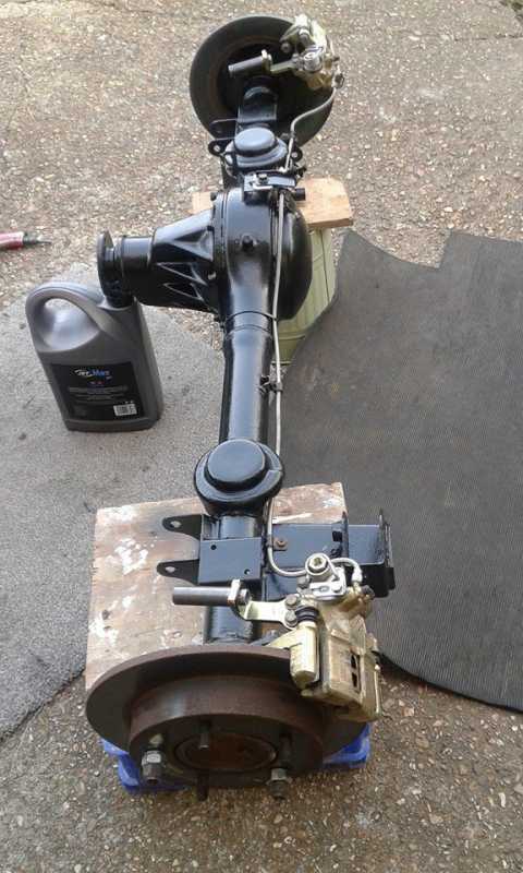

I have fitted a muddyzook conversion to my jimny and now im a little confused as to how to plumb them up. Mainly the brake correction valve ideally id like to remove this and put a block in its place and use the existing brake lines to fit to the calipers. a point of note is that i have done a 2" body lift and a 4 1/2" suspension lift.

You will need to buy a m10x1 tee and mount it on the diff crown also 2 long cranked banjos and bolts and seals also 2 long straigt fittings and 2 metres of pipe all in -3 fitment assemble it all up and bleed the system rear rubber hose will stay in place as is unless you are lifting the car load sencing valve will also stay in place

The valve is there for a reson just use a T peice of the flexi hose to each caliper

sorry i meant 4 1/2 not 6 1/2 spring lift, i bought it years ago and only just got round to fitting it, cant say i was overly impressed mind. So because i have lifted it does the spring to to be streached or just make a brackt for it?

You can buy a riser that goes on the axle to move the spring up i didnt bother with my 4.5" lift brakes still worked fine
