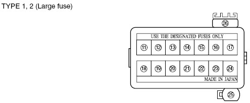

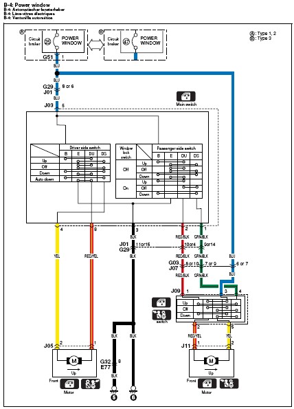

depends on your model
25 = power window circuit breaker
or
if you have the small fuse
47 = 30A fuse
taken from the service manual, you can find here
or
47 = 30A fuse
Last edit: 04 Apr 2014 15:20 by Halford.
