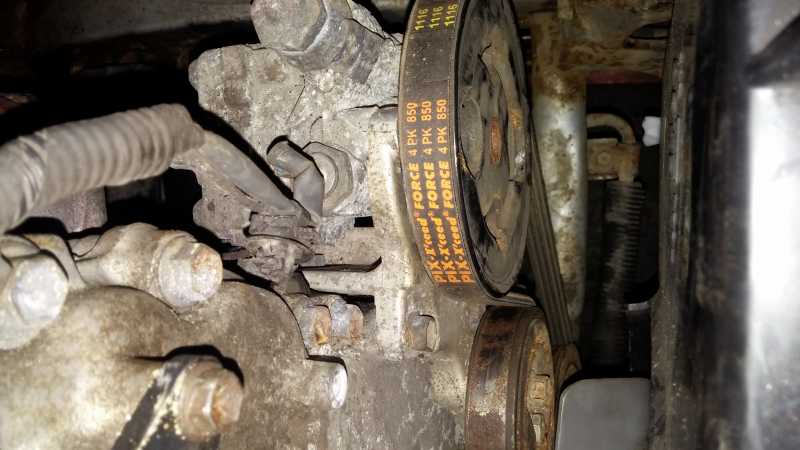

What belt?
Got one from euros today 4pk850...............................and it doesnt fit.

Grey pick up Jimny
Replied by j999pre on topic m13a PAS belt?
Odd I'm sure i just fitted one that size on an m13a

Replied by jonesyba420 on topic m13a PAS belt?
Had the tensioner fully loose and it just wouldnt quite go on :evil:
How did you get it on?

Did you undo both the nut and the bolt? I used a hex then to swivel the tensioner and it just slipped on.
Yep did exactly that, wouldnt go on for s#$t!

Replied by Tadpole on topic m13a PAS belt?
I changed my belts with ease once the hex alternator bolt was freed off using these M13A 2003 hth .............. :dry:
Auxiliary Belts
Alternator size 4PK 835
Power Steering 4PK 854
Auxiliary Belts
