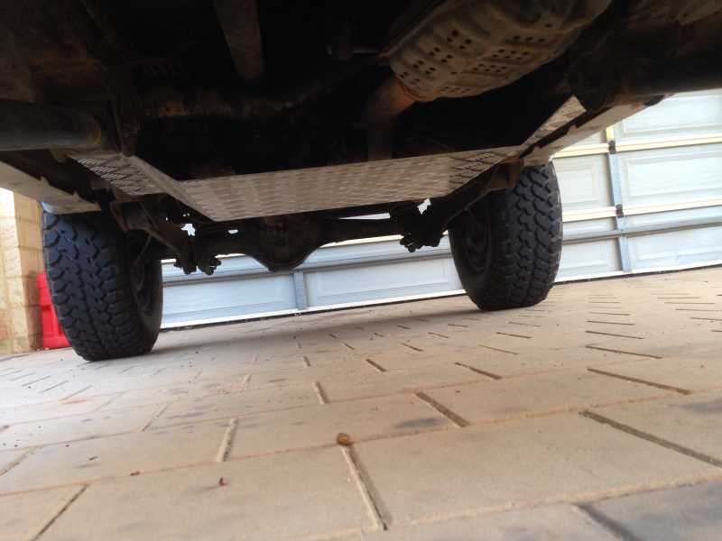

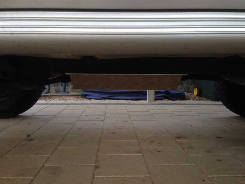

Hi there guys I decide the other day to go aheAd and build me own transfer case guard but I'm having second thoughts now as to how I have built it because I have lost a lot ground clearance almost 3and half inches I've posted some pictures let know your thoughts of what you think
  • Millzy
21 Feb 2014 10:51 #105406 by Millzy
Replied by Millzy on topic Transfer case gaurd my own build
some feed back would be great as what other people have found is best as it is all same height now as the castor arms but it is middle car so think i maybe straping alot dunno weather to continue bolting on or take of start again

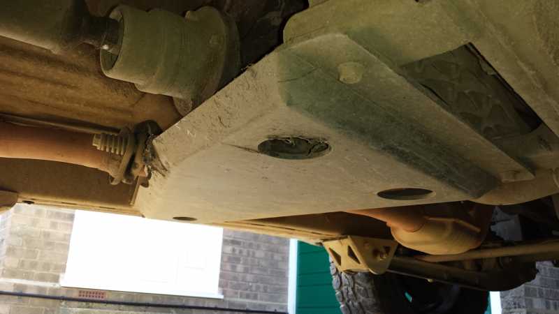

the drop on the ORA one is no way near that much but it does have a notch out of the rear edge for the exhaust, this may be what you need.
i highly doubt checker plate will be strong enough either tbh (unless your using it to make a template) it idealy needs to be able to take the weight of the jimny.

21 Feb 2014 11:20 - 21 Feb 2014 11:22 #105409 by jonesyba420
Replied by jonesyba420 on topic Transfer case gaurd my own build
Heres my ORA one (its abit muddy lol).
You can just see (through the mud) the notch below the exhaust.

ok that looks perfect well i was trying go cheap way around it but now think ill just have bite the bullet and splash the cash were can i find one like that >>
