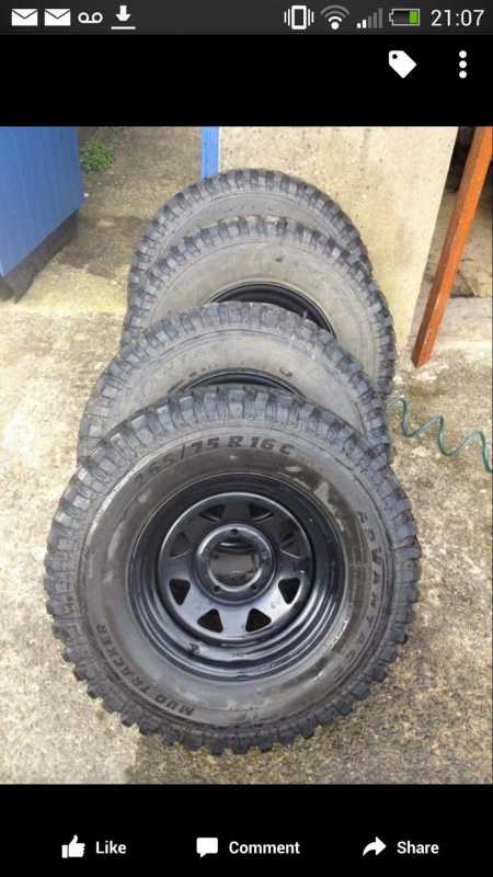

Langdonm wrote: If bought 265/75/r16
Guessing I've got no chance with no lift then ?
Would they fit if the arches and bumper were cut ?
you will need at least a 4" lift,lots of trimming and a rocklobster box and alot of spare shafts.

02 Oct 2015 21:28 #152892
by Langdonm
Replied by Langdonm on topic Tyre Sizes - Rough Guide Thread
- TomDK
04 Oct 2015 09:21 #152969
by TomDK
Well.. more or less.
You'll do fine with a 2" lift. It's just a matter of buying the right springs.
Replied by TomDK on topic Tyre Sizes - Rough Guide Thread
