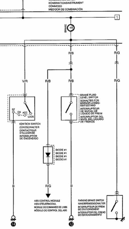

the brake warning light serves both the handbrake and also the fluid level.. try this:
1. Disconnect connector from brake fluid reservoir - if problem goes you have a faulty sensor or fluid level problem
if problem persists
2. Disconnect connector from handbrake - If the problem goes the switch is the likely culprit
3. short the two connectors in the plug - if the brake light comes on on the dashboard then the wiring is fine and the switch is definitely the cause (give it a spray with WD-40 as it might be wet).
If its still not working then its either the ignition switch or ABS if you have it fitted.
from the manual
if problem persists
from the manual

Replied by markyp2000 on topic Handbrake light stays on.
Its the ignition switch theres is so iv been told on here a black bit that causes it iv never had the problem so cant be 100% on the black bit but in sure 100% its the ignition switch
12 Nov 2013 06:19 #90551
by facade
Replied by facade on topic Handbrake light stays on.
AS Mark says, it can be the ignition switch
Yellostreak's diagram shows a connection to the ignition switch that earths the bulb out when in the starter position (probably a bulb test) the VR coloured wire on the left (violet with red trace?)
If disconnecting the handbrake switch and the reservoir switch don't work, disconnect that wire from the ignition switch (I don't know if anything else connects to it that isn't in the diagram though)
