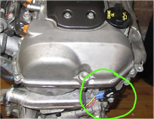

Hello all,
It seems I have the same problem as many have already stated here on the forums, which relates to the
camshaft/crankshaft sensor/s being faulty.
I've located the crankshaft easily between the alternator and the engine block but I can't seem to find the what most people regard
as easy to find camshaft sensor. As far as I've seen here on the forums it should be located on the front right of the engine block but I can't find it.
All I see there is a blueish connector with two wires but I don't see the distinctive shape of the camshaft sensor.
I'm attaching photos...
Any help would be appreciated.
Thanks,
Boaz.

That must be it, behind the silver pipe with the blue connector.
It has to face the cam sprocket, so it is in the right place, it must unbolt and pull out forwards.
I think this is it, but I'm looking at a photo of a VVT, I've never seen one.

I guess you're right about the sensor's position. This is what I was also thinking, I was hoping someone who has the same engine
could confirm that.
