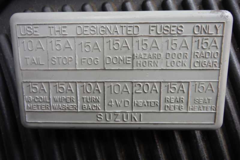

The heater fan/blower on my jimny seems to have packed in- nothing happening at all when I flick the switch across to on. Any ideas what this could be?
I was thinking a fuse had gone but wouldn't have a clue which! I pulled then all (except the top one which wouldn't come out?!) but not being mechanical dont know what I'm looking for!

The black one is the main fuse and it is bolted in from the sides
Check the fuses under the dash on the drivers side
Its a 20amp fues inside it tells you on the cover

First thing to do is alway check the fuse if it blown there may be a problem the heater motor may have seized up or could be the resisor or switch

Its the 3rd one along fronm the lef on the top row
