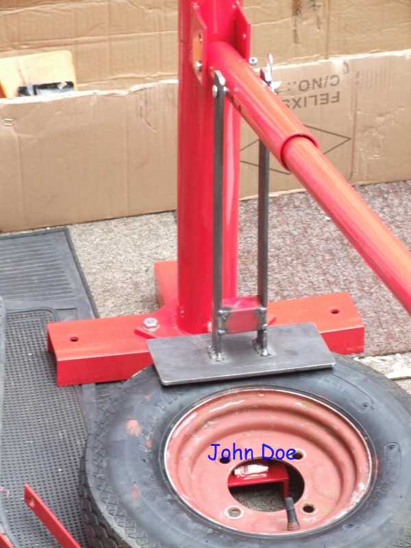

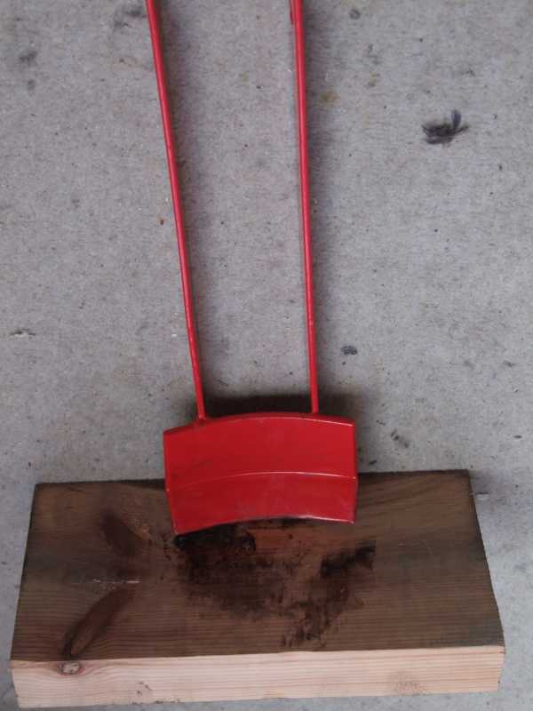

One thing I noticed looking back is that mostly all the attempts used a block of wood or something wide and flat as opposed to a chisel. I was about to give up when I thought back to the tyre fitter's equipment and again it was a flat (but rounded pad). Nothing chisel like at all so that's why I had one more go with a flat block of wood. So I am going to get some rectangular steel tube and either make a complete replacement for the chisel fitment part or make a slip on/over end. This is the chisel end,see the radius which I don't think is the same as the tyre bead either.
Here is the solution.
Take a look at the equivalent on this one.............it looks to me like a flat end.
