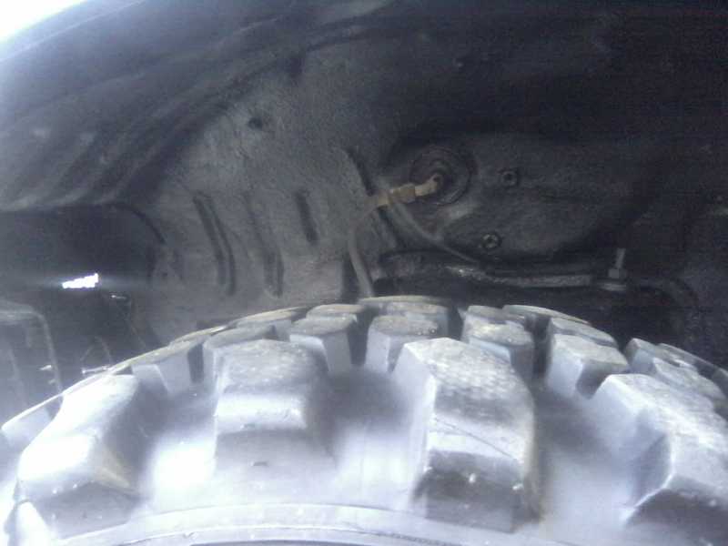

30 Jul 2013 18:10 - 30 Jul 2013 18:26 #78617
by nicho
Replied by nicho on topic Waxoyl
this is from when i did mine.
after a bit of research i bought some of this today,
i treated the bits of rust i had earlyer and made a start ,the bits i have done look realy good especially being done with a brush just need to get some gloves as its a bugger to get off your hands, think i need 1 spray can just to make sure i get to the hard to reach bits.they recon it deadeneds nosie a bit to but it must be minimal.im inpresed with how easy it goes on and what it looks like when its on.did inside front arches seeing as i have took the plastic bit out due to trimming the arches and looks good as the car is black anyway.
1 week later
well finaly finished that job took longer than i thought and very messy but it looks good and finished of the bit i couldt reach with this.
1 week later
