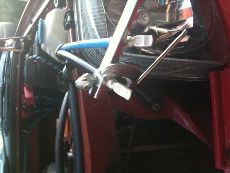

06 Feb 2013 18:16 #61146 by Johnniehec
Replied by Johnniehec on topic Re: Winch power cable
I crimped mine with a brake pipe flairing tool
