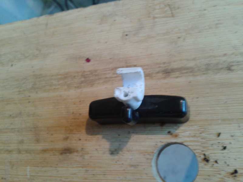

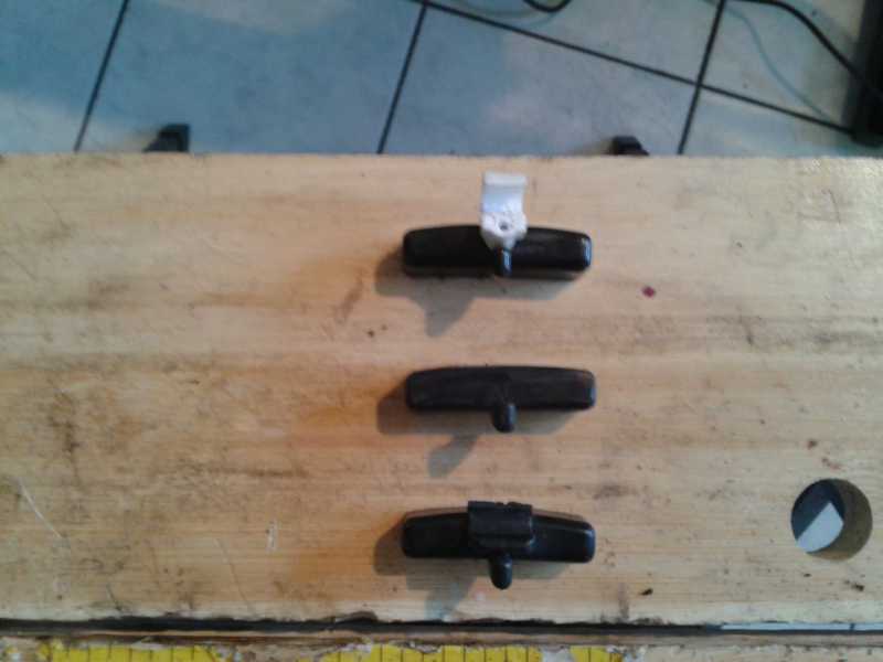

I can`t stand the thought of keep buying hood clips for my Jimnybob every 6 months when they break.
Bit of a thunk and a trip to B+Q bought me a pack of 10 nail in pipe clips for £2.
I bought 8mm and 10mm so I could see which ones worked the best, this trial version is a 10mm one.
I looked at the cable clips too, but they weren`t as fully rounded as the pipe clips.
Step one : Cut off the broken clip remains.
Step two : File the mating surface flat.
Step three : Drill the centre hole through in the rear of the clip.

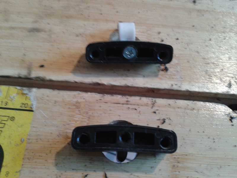

Step four : Screw your 10mm pipe clip on from behind with a self tapper.
I also opened out the centre hole slightly and countersunk it so my screw sat inside nicely.
