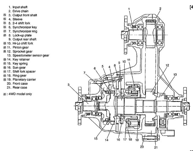

I'm looking for some sort of diagram (exploded or otherwise) of the transfer box, as I've been presented with a modified car with problems and asked to fix it.

Any wisdom, or pictures most gratefully received!!

Grandmothers and eggs and all that, but the usual reason for being stuck in 4wd is wind up in the transmission: simply jacking up one front wheel will cause the wheel to twang and turn round half a trurn or so, and the selector will work.
All that happens is the lever moves a fork that slides a collar over dog teeth on the front of the rear output shaft, and the rear of the front output shaft.

Thanks chaps, it gives me a bit better idea of what's in there.
Pretty sure its a Jimny transfer box under there, hopefully be nice and easy to sort.
