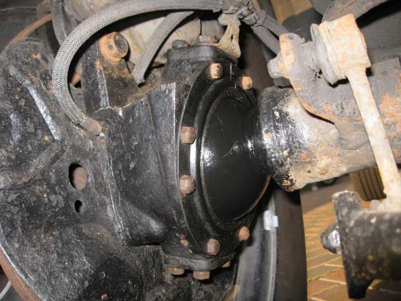

Before you spend money, park on the drive, get a torch and examine the pipes underneath, you can do this lying down, you don't need a jack.
Starting at the wheel end, you will see this:
The two rubber pipes are what you are following. Make sure they are connected at both hubs, then follow the two pipes, they go to metal pipes that run along the axle, and tee off along the drivers side suspension arm on the inside. Check that nothing is detached or broken. Favourite is the pipes split and come off the hub end.
If you can't see anything obvious, things get expensive quickly.
