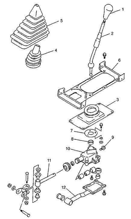

04 Nov 2012 19:29 - 04 Nov 2012 19:34 #52276
by facade
Replied by facade on topic Stir Fry 'Shifter...
Take the plastic centre console out then it looks like plate 6 comes out from inside the car, then plate 3, then undo 3 bolts through plate 7 and the stick lifts out.
The bush is next to the pink mark.
Not sure about part 8 could fit the large ball on the stick.
You can see that there are loads of bolts to fall out/work loose
Can't see the pink mark, it is the at the bottom above the rectangular plate with the arm on.

04 Nov 2012 19:38 #52278
by facade
The little bolt shown above the rectangular plate on the left goes upwards through the ring eye into the hole in the short shaft, and it falls out :ohmy:
Looks like a major job to tighten it up as well.
Fingers crossed it isn't your problem
