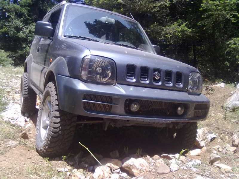

as above want some chunky tyres how chunky can i go with out needing a lift

205/75/15 or 215/75/15 as long as they are new tyres and not remoulds as they are some time larger, and it's not the facelift jimny with the large bumper or you will need to cut it down like in the photo.
