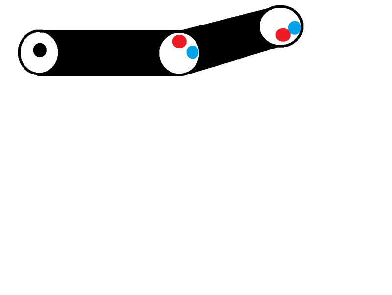

  • Smoggy
19 Oct 2012 19:28 #50839 by Smoggy
Replied by Smoggy on topic 33s Rubbing
Is there enough room in trailing arm "forks" to do that before the axle housing hits on the front side of them? (If that makes any sense... :laugh:)[/quote]
Thats what I thought Panosd was referring to as well, but lots of the greek guys have actually moved the mounting points on the chassis by 3cm, which I think will be more straight forward. Just cut it off with a slim cutting disc, move it 3cm forward then reweld it on the chassis leg again?
What do you think.
  • Smoggy
19 Oct 2012 19:30 #50840 by Smoggy
Also I think this action will affect the castor cos you are effectively rotating the axleback over are you not?
  • markyp2000
19 Oct 2012 20:20 #50847 by markyp2000
Replied by markyp2000 on topic 33s Rubbing
red bit is if you was caster correcting and blue bit should move the axle forward with out upsetting the caster angle fit you get my poor pic lol
