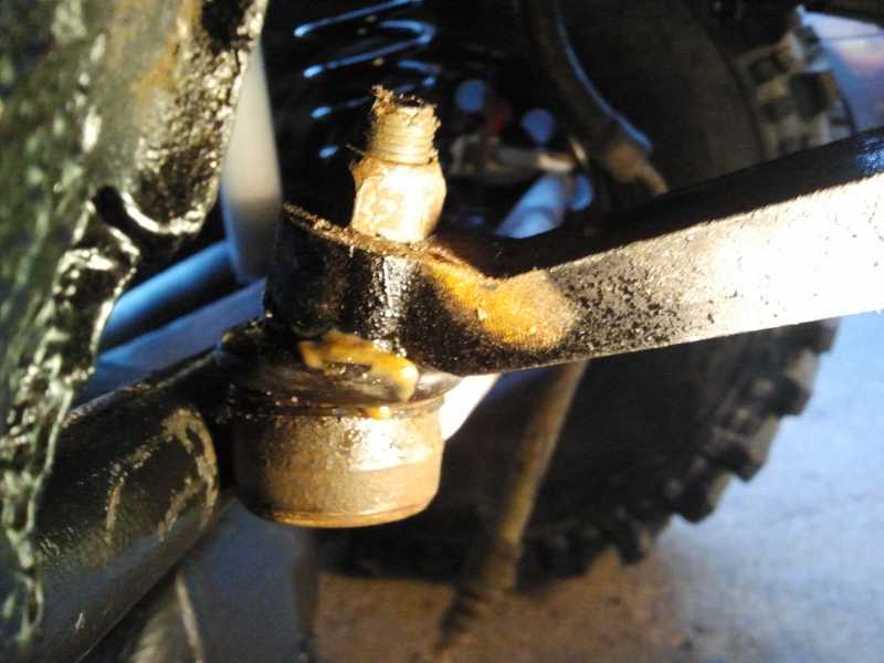

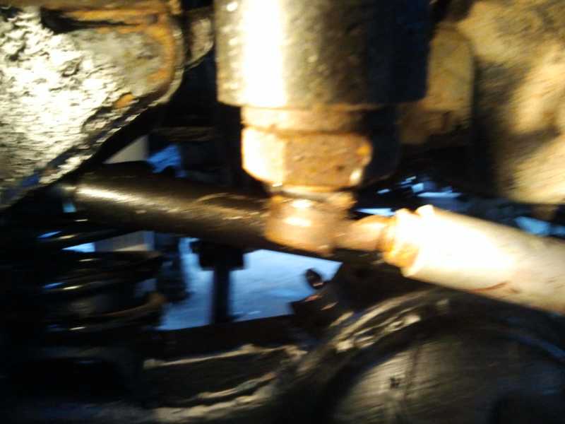

Well I have finally got my Jimny onto 4 wheels
However I have a problem where my track rod attaches to my drop pitman arm, it fouls my panhard!
I wish I had listened to Paul 4x4 who said:
quote Bodylift doesn't affect steering geometry in any way, so there's no need for dropped pitman arm on just 3" suspension lift. People just seem to have some weird urge to bolt every aftermarket part onto their trucks without even knowing what they are meant for...
I bought my drop pitman for about £80ish and had considerable work (and problems) fitting it
When really perhaps I should have saved my money and work and kept the original.
Now I am thinking about refitting a standard pitman to overcome my problem, but with the 33's on and 4.5'' spring and 2'' bodylifts the steering joint will be working at a ridiculous angle.
Any suggestions guys. Could I perhaps use a one off rose-jointed connection to the pitman instead of the standard track rod end.

i have a 4.5" lift and i have a standared pitman arm what make panard rod are you using
- Smoggy
06 Oct 2012 20:21 #49634
by Smoggy
Replied by Smoggy on topic Panhard fouling steering arm
The adjustable one from the ORA 4.5'' lift kit. I dunno if you can see in the pics but the steering arm is a one of with HD oversleeving.
- markyp2000
06 Oct 2012 20:24 #49635
by markyp2000
Replied by markyp2000 on topic Panhard fouling steering arm
on your panard rod did you get the cone spacers things could you not shave some off so it sits towards the back and then space it at the front with washers
- Smoggy
06 Oct 2012 20:27 #49637
by Smoggy
Marky your an absolute revelation and that well and truly deserves a thankyou, it might just work
- markyp2000
06 Oct 2012 20:32 #49638
by markyp2000
glad to help it does help to have some one else to look/think of how to solve some thing let me on how it works BUT thinking about it make shore the panard rod still clears the diff casing if you have a guard fitted if you do shave some off the guard to lol
