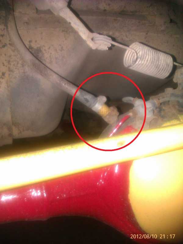

for the diffs what size pipe have people used
would 13mm be about rite?
and would that be rite for the transfer box as well
what have other people done, any pics if any one has any?
and is there any thing I need to know such as the length it needs to be between the chassis and axle
I don't want it too long (will pinch the pipe and not work) or too short (will snap)

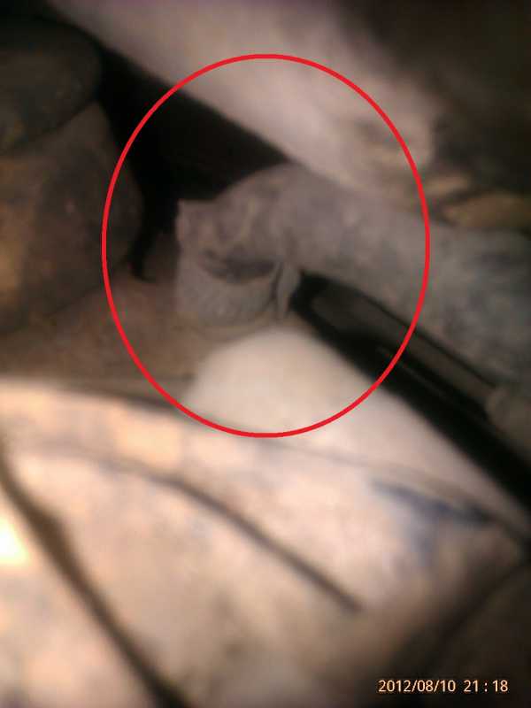

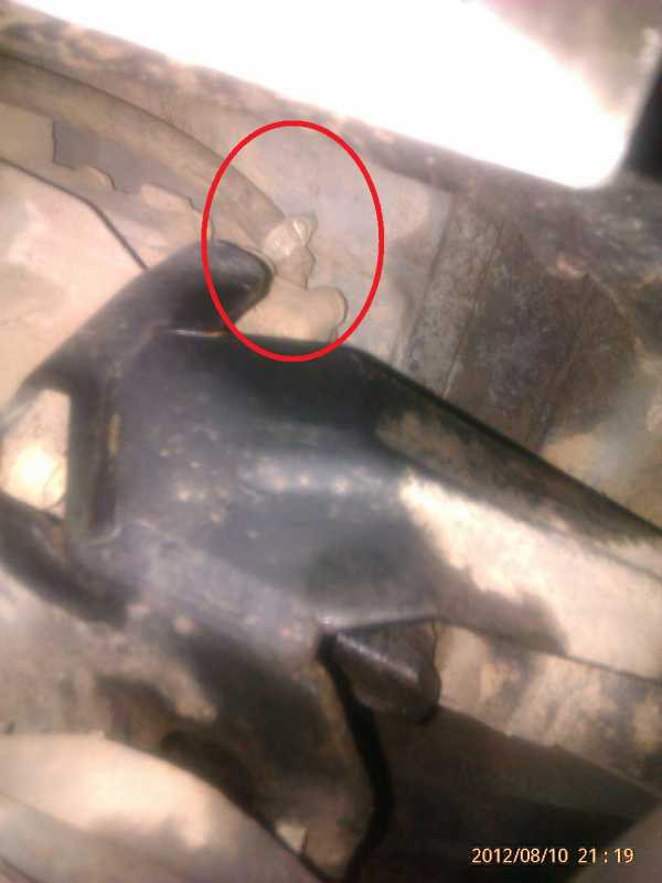

for the pipes on the diff just run in along the top of the trailing arm to the chassis and you wont need any pipe flopping around underneath then run it along the chassis up to your snorkel or engine bay as for size of pipe on the diff i used standared garden hose
front diff
rear diff
tbox

i think the gbox and tbox pipes are 6mm or 8mm just got that from halfords thay are not easy to do i had to lower the gbox and tbox to fit them

as the axle breather have a cap over them
why is there any need to put pipes on if no water will get in?
  • markyp2000
10 Aug 2012 22:40 - 10 Aug 2012 22:44 #45878 by markyp2000
Replied by markyp2000 on topic Re: breather pipes
if water didnt get in why would i put pipes on it belive me water gets in if air comes out of a beather then water can get in knock the caps off with a screw driver and fit a hose on it other wise you will be replacing diff etc
