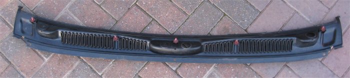

adamatdraycott wrote: I've tried removing that black plastic trim from infront of the windscreen... gave up after taking everything off and it was still stuck solid!
Once the wiper arms are off and bodge pegs are removed from the front, it wrenches off, held by some expanding pegs.
Oil the hinges while you are under there.
