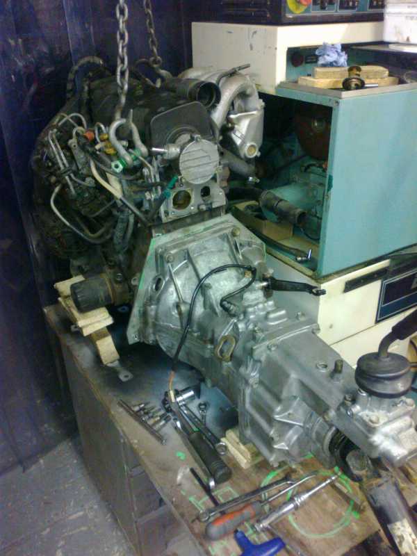

Baleno Injectors fitted with jimny fuel rail just had to turn up an offset threaded spacer to deal with the longer injectors so rail could go back on its mounts
Fitted all up with the throttle housing removed exspecting when i put it back for the throttle quadrant to clash and hey pretso at least 2mm of clearance so happy days.
Just need to try out my new tube bender and make up the 2 inch exsaust system to be able to give it a try

Ran it up tonite runs much sweeter thru the range but idles rough as hell still any suggestions before i throw it in the bin and fit the diesel that was all ready to go in :(
