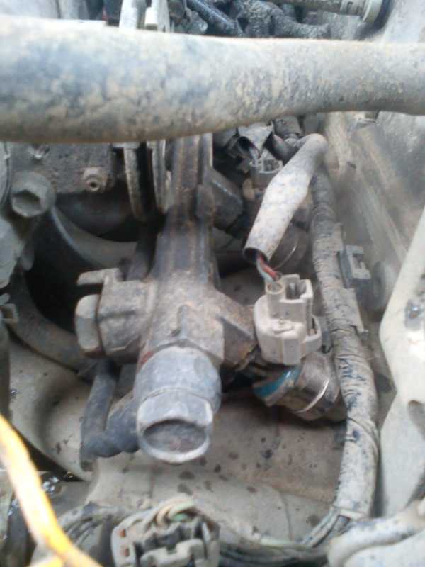

- zuki andy
09 May 2012 18:08 #39758
by zuki andy
Replied by zuki andy on topic Re: Injector issue
Hi dave, there is a couple of people breaking balenos on ebay. i brought mine from a breakers off ebay for £37 complete with the fuel rail. they were off a 1997 model baleno. they are green with a stainless steel body which are longer but fit if you use the baleno fuel rail. but someone else on here had got some just green ones off a baleno and they were a straight swap. i can only presume from a newer model baleno.

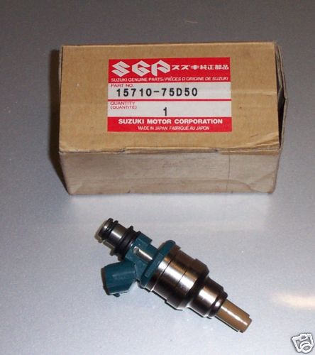

- Dave c
09 May 2012 22:25 #39800
by Dave c
Thankyou think i may have found what i needed from your photo have attached a photo of some Baleno injectors that i have been offered and they look the same a yours you really have filled in the missing link Dont know if you know what the part numbers are for yours but the ones ive been offered are
Denso 19550-2350 / Suzuki 15710-75D50.Have searched high and low on the web to cross ref them but absoluty nothing.
I know i wont get the fuel rail but sure i can do somthing to fit them to the jimny rail its only a pipe after all.
Did you have a remap after fitting yours ? have been speaking to rhinoman and says he can carry out that for me if required.
Many thanks again you have been a great help
