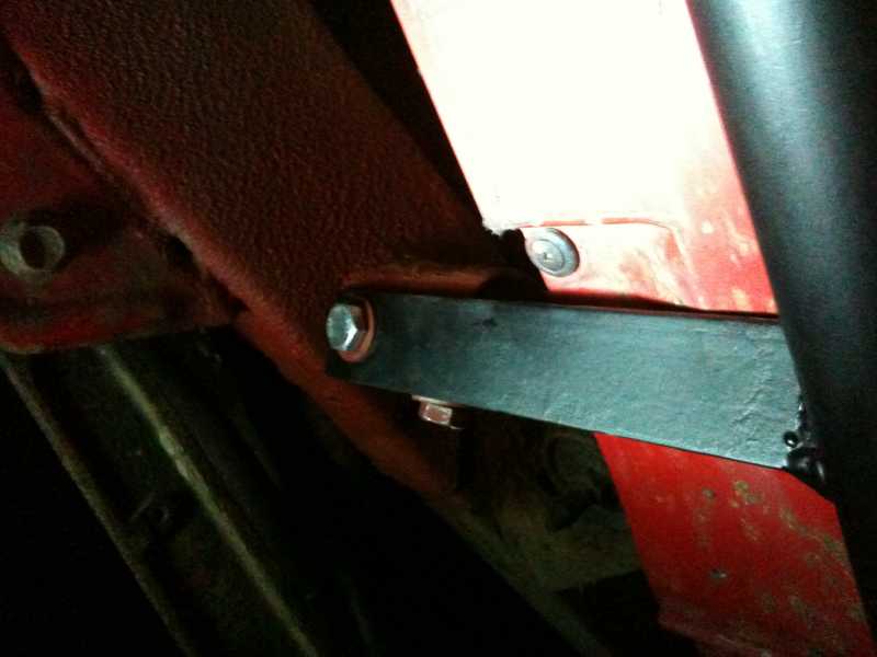

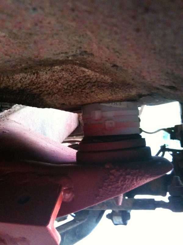

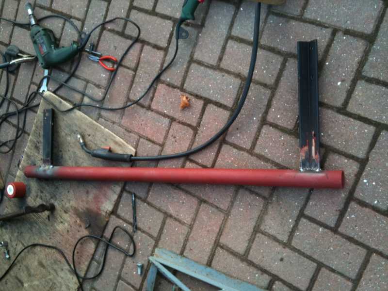

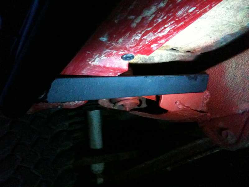

18 Apr 2012 19:10 #37928 by renard38
Replied by renard38 on topic Re: ROCK SLIDERS from off road armoury
pictures ;)
i want this.... so:
[img
repair
[img
[img
[img
[img
[img
[img
[img
[img
[img
[img
[img
[img
A+
19 Apr 2012 11:55 #37994 by Johnniehec
Smoggy wrote: Just a thought on welding your own sliders. Does anyone have any templates for making your own box section sliders, I fancy knocking some up myself and would be grateful for any info. I do have a 2" bodylift if that affects anything. Cheers.
Smoggy,
The 2inch body lift will give you access to the outriggers rather than go all theway to the chassis, mine's only 30mm but attaching to the outriggers means the mounting bars are shorter and less likely to get bent. My bars a re scaffold but box section would be the same principle.
John.
The following user(s) said Thank You: Smoggy
