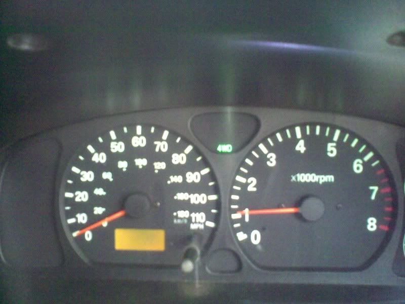

had the transfer box out to clean all the crap off it and oil change yesterday
back on now and speedo not working, re-seated and cleaned connection to speedo sensor. still nowt. speedo in dash wont even show milage. all other instruments working. any got any ideas ??
would a broken wire cause it to stop showing the mileage ??
29 May 2011 08:23 - 29 May 2011 08:23 #17050
by jonplace
Replied by jonplace on topic Re: speedo not working - sj transfer box on jimny
sorted it. disconnected battery for 5 mins, reconnected and all is normal again. reckon this thing has a mind of its own !!
maybe i should have disconnected battery before removing box ?!?!?!?!
the main thing is all is well again and i can see how slow i'm going
Last edit: 29 May 2011 08:23 by jonplace.
