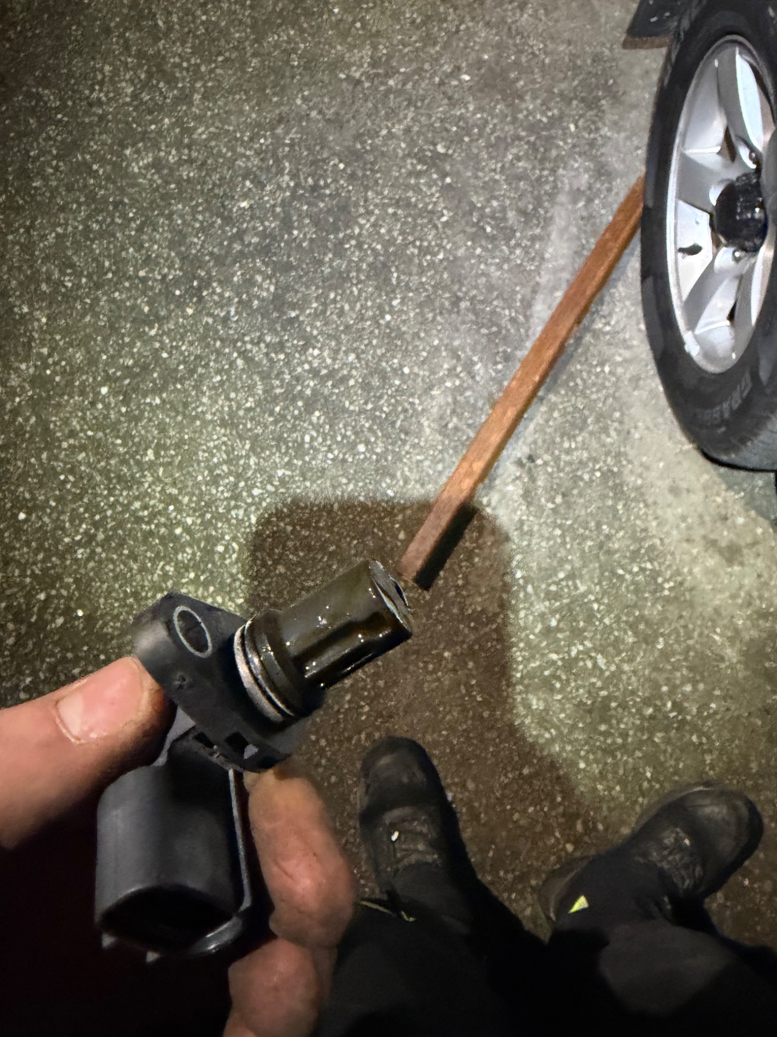

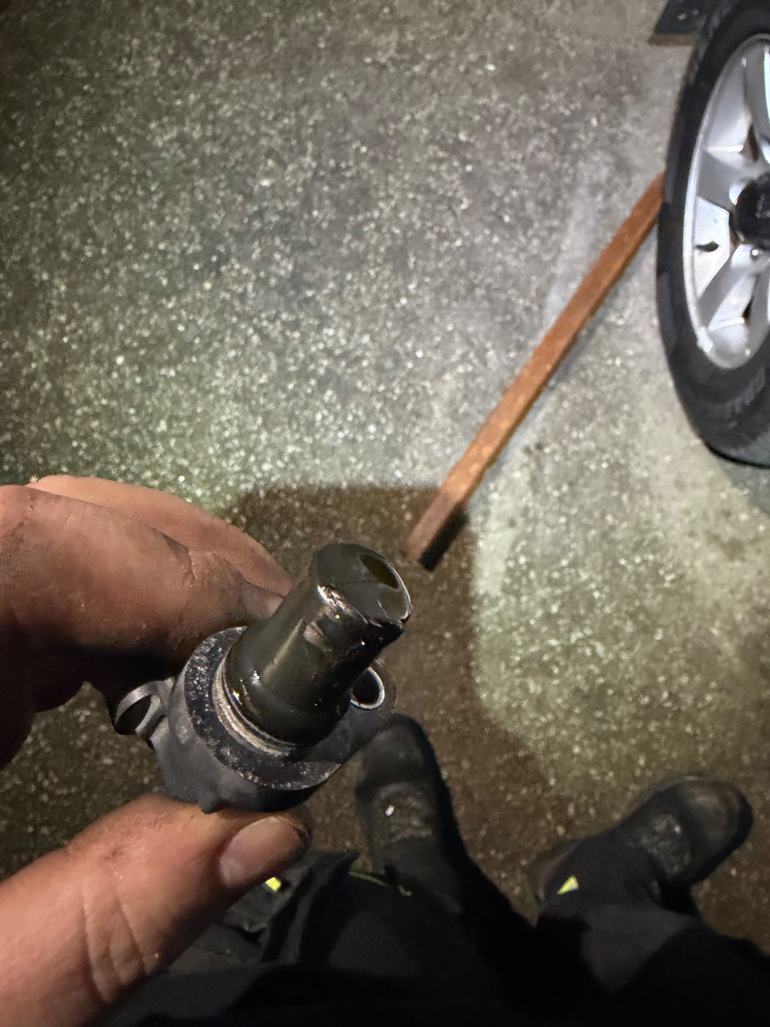

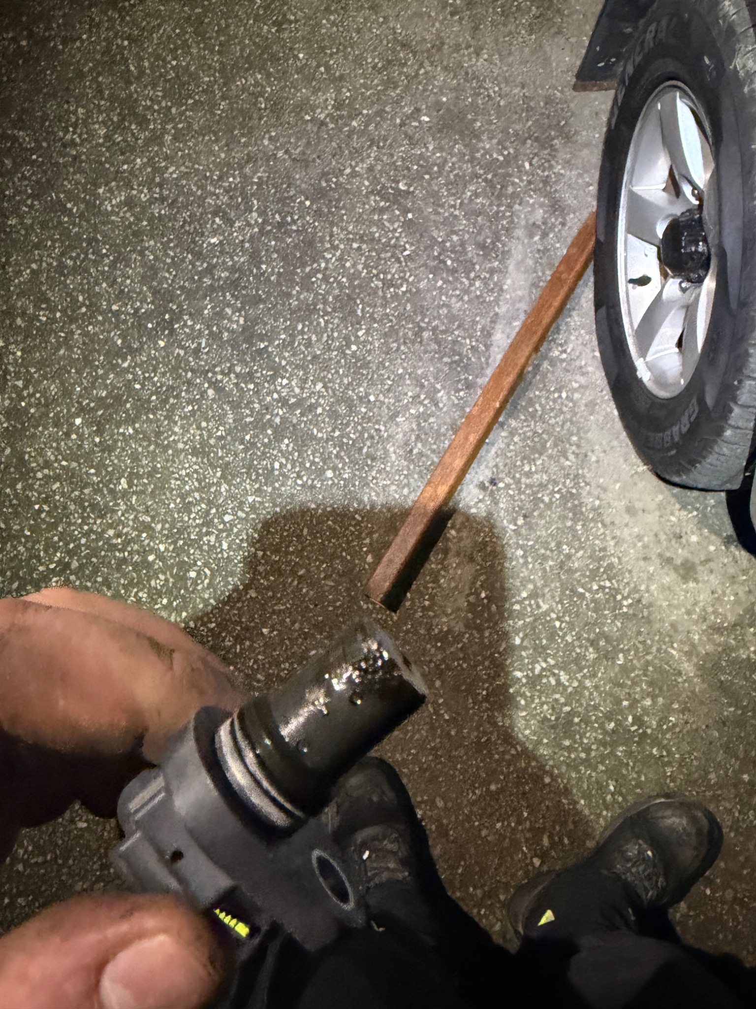

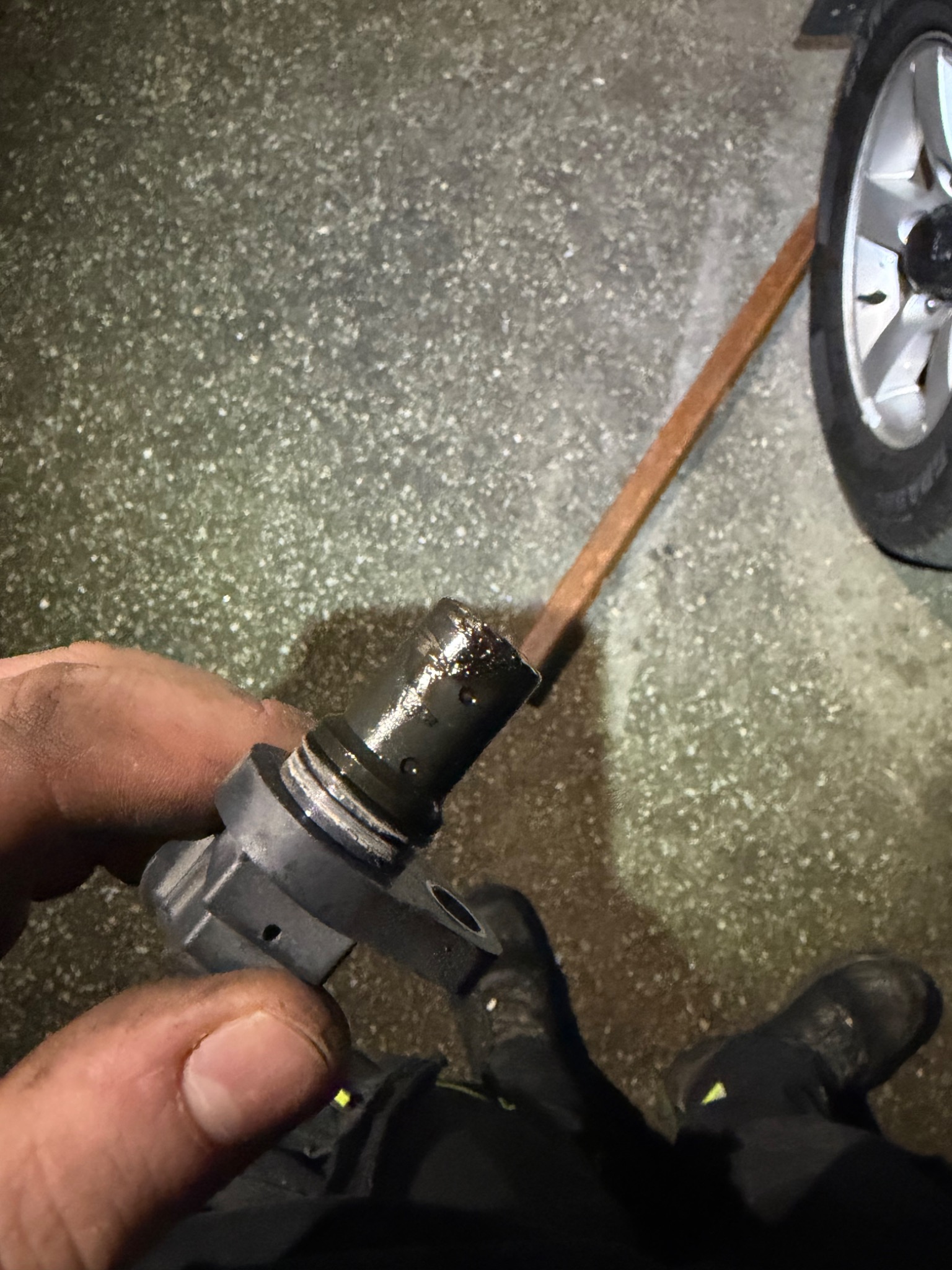

        Bought a 2007 1.3 jimny and its started to bog down when you excelerate nearly like a misfire i pulled the coils and tested them and plugs they are fine. So i pulled the cam sensor there is a small amount of metal shavings on it should i be concerned?

Do you mean crank position sensor? Changing it will most likely fix the misfire. It's magnetic so will attract metal filings. That doesn't look like a problematic amount, but I'd cut open the oil filter and inspect just to be on the safe side.

Yes crank piston sensor. I cleaned the sensor and put it back in seemed to stop the misfire for a few miles and started again so hopfully thats the issue i ordered a new one today. Also going to drop the oil and check filter and drop sump and clean the pickup
