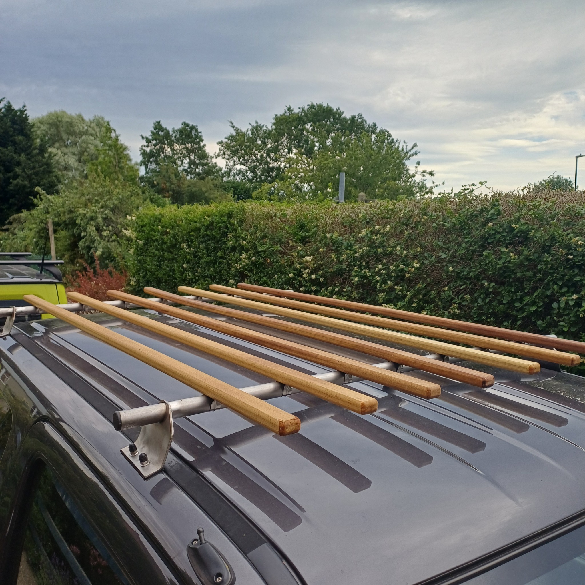

Just be aware that some of those flat racks can weigh almost all the roof carrying capacity on their own, as it's only 30kg. I made my own that weighs 5kg out of stainless steel and iroko wood.

Ah thanks yes that's a good point. The one I was looking at is 24kg so doesn't leave a huge amount for extras.
I hadn't considered making my own but that's a great idea!

Replied by Lambert on topic Roof rack/awning recommendations

Looks great!
