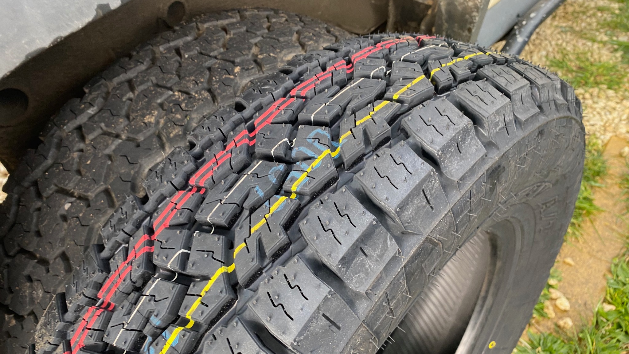

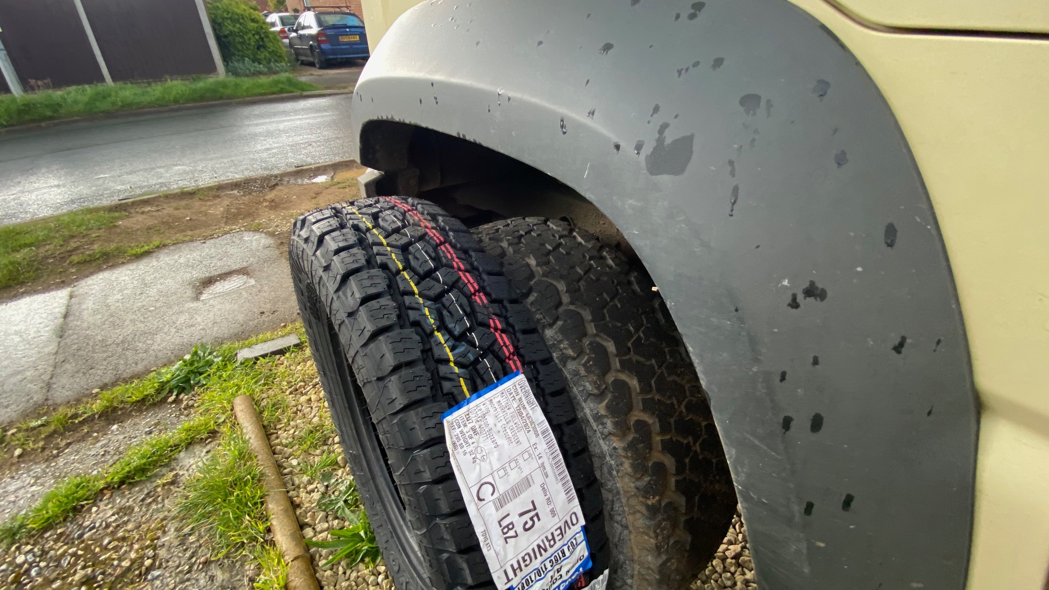

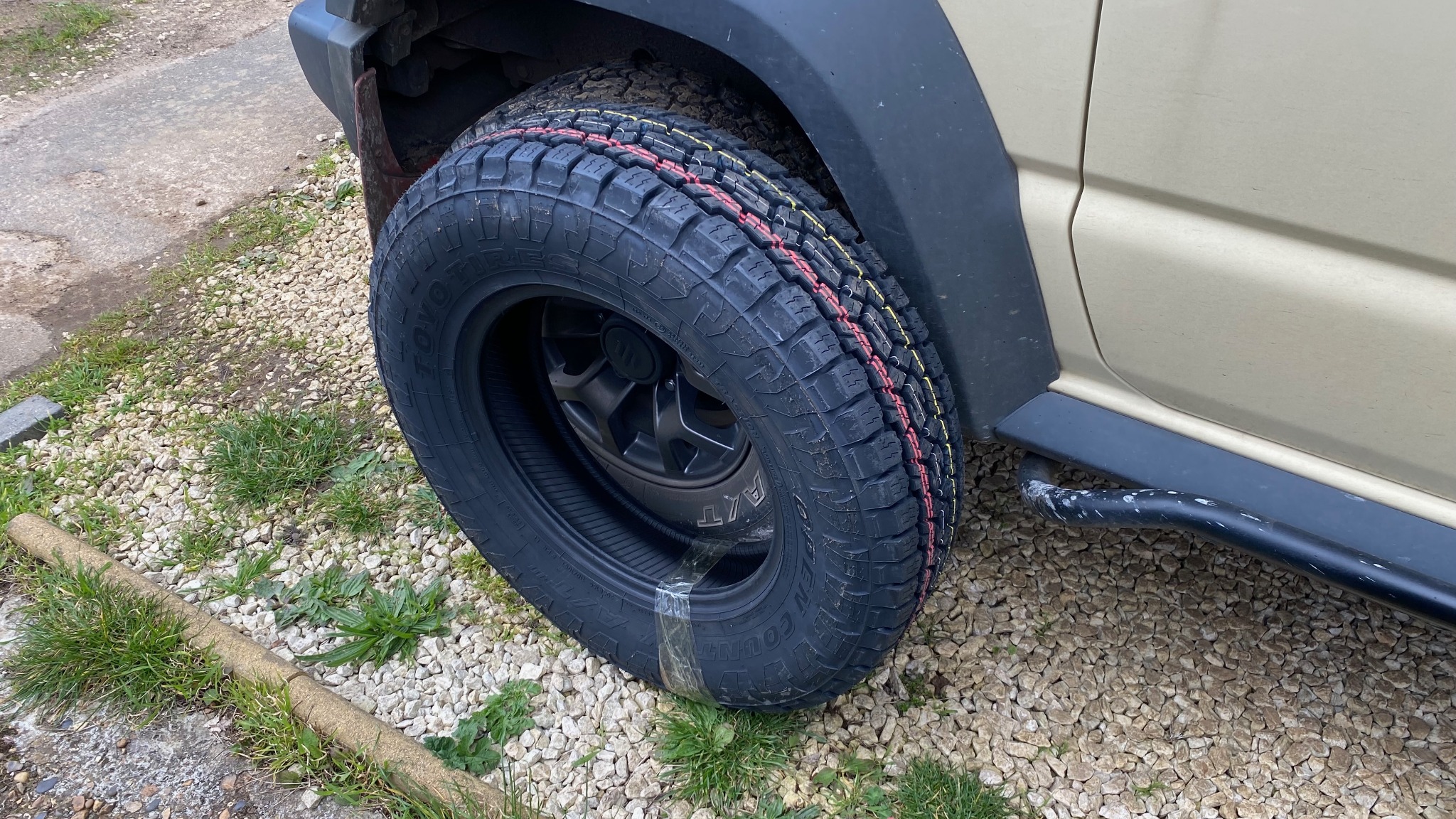

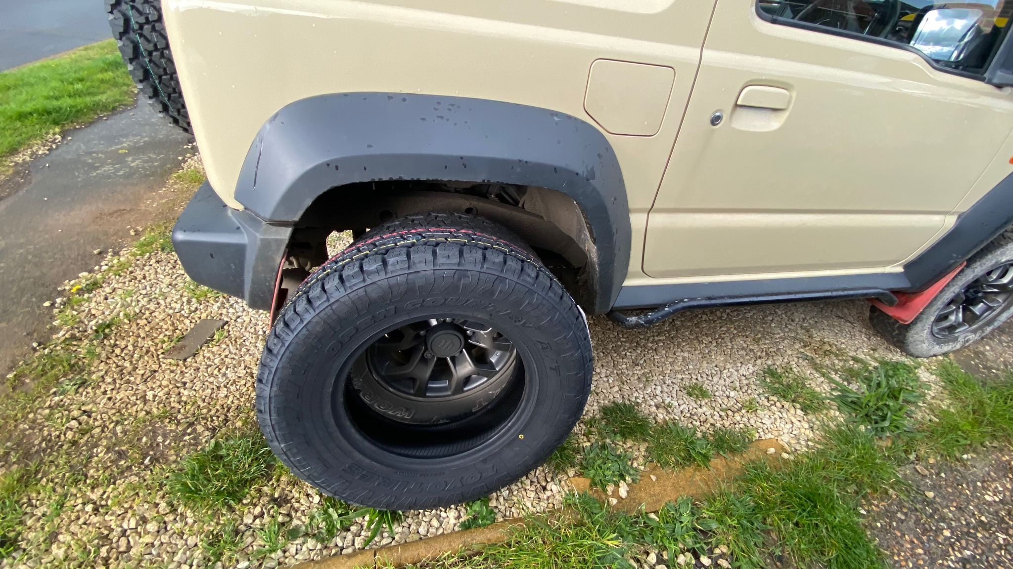

Here is a 205 x 16 compared to the 215/75R15's. The 205 is not mounted and has no weight on it, but they look surprisingly a lot taller than the stats may suggest. And these aren't remoulds, the Insa Turbo 205's are likely quite a bit wider and probably a bit taller.
