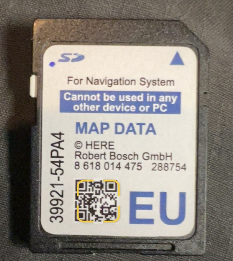

My first question to forum members........ how does the user know if the SD card fitted in the Bosch SLDA Satnav unit in my car is the latest version? I have found a site selling an SD card, which is marked Suzuki and dated 2023 with alleged compatibility for the Jimny.
Staff at my dealership have advised to use Garmin Express and download the latest info onto an SD card. I've also seen info on the 'net about using Garmin Express installed on a lap top and link the laptop to the car's USB port.
The handbook says to visit Suzuki-Slda and load data from it onto an SD card but that site appears to have closed. Any info how I can establish what the status of the sat nav mapping currently is and how it can be updated would be much appreciated.
I've attached an image of the card currently installed in my unit.

54PA4 is from 2020. The latest version is 54PA8.
The SD cards have a write once special ID that has to match the map file version, so mostly you can’t just download a new version.
Separate from the map files there is also a head unit firmware version which you can download and update if needed.
There are plenty of people on eBay who sell genuine SLDA 54PA8 memory cards for around £20, most say 2023 as that appears to be the last time the maps were updated as Suzuki moved away from Bosch SLDA and it is unclear if there will be any new updates.
