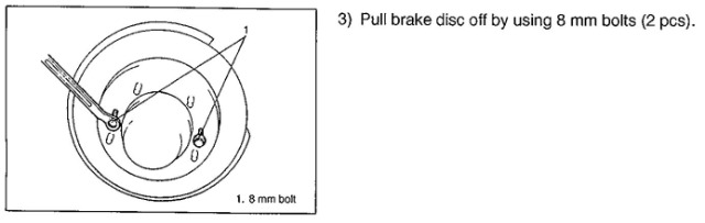

Please don't beat on the disks with a hammer, it's designed with "jacking screws".
