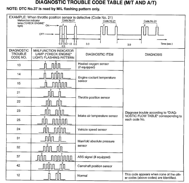

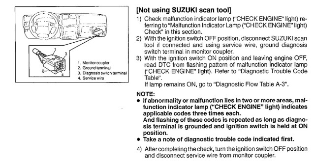

This is a 1998, so no post cat lambda and no OBD2. Can anyone advise on how to jumper the plug behind the glovebox to get an OBD1 flash sequence with ignition on, I was going to try black wire connector to red as a guess but would appreciate assurance that this is correct please?

I've never messed with the G series engine, according to the manual there is a separate connector hidden somewhere behind the dash to get the MIL to flash out the codes, I wouldn't expect any (except 12 = everything is awesome..) if a sensor is reading incorrectly, they have to be obviously broken for the ECU to realise.

The old skool diagnostic does a repeated 12, so I think that lets the ambient temp sensor, and MAP sensor off the hook. Possibly the coolant sensor too but I guess only the heater circuit tested on the lambda.

As anticipated, 12 means as far as the ECU is concerned everything is tip-top, and it is fuelling correctly according to its measurements.
It has no way to tell if a sensor is giving duff readings unless they are outside the realms of possibility (it is more a test for short circuit to ground or open circuit due to bad connections), so if the ECT reads low it assumes the sensor is right and the engine is cold.
