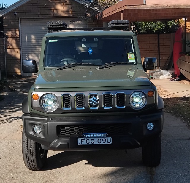

I've got a little one one mine and it doubles what the headlights alone do, it gives a heap more light over a bigger area then the standard headlights can.
down here where we have long roads, little traffic and lots of wild animals it's probably the most valuable mod.

This link shows what the small bar does. As stated, with it being low down, although it helps, is not the best place.
youtube.com/shorts/ip-Jd0tBV4o
