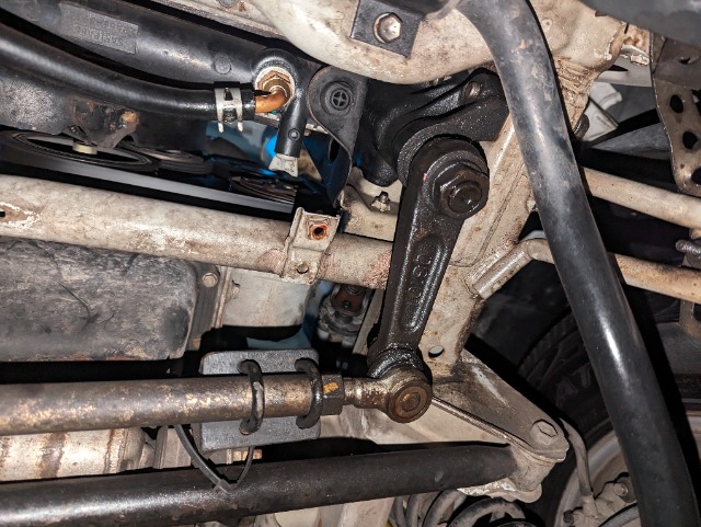

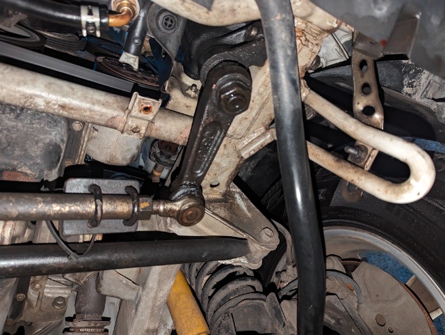

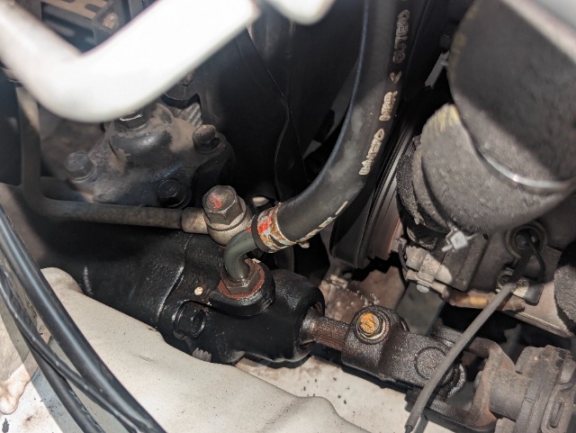

After having my engine and transmission mounts replaced and spent $$$ on it, I encountered a new problem:
Day 1: I noticed a whining noise in the driver side of the engine. I looked and found that somewhere in the power steering pump is wet. Fluid is still in optimal level
Day 2: I saw a drop of PS fluid on the ground and the whining noise still there.
Could this be Power Steering Pump issue? Is this common in JB43?

There is a small metal elbow pipe on top of the steering unit. This is fragile and splits with age. It is suspiciously near the engine mount and could have been knocked. Your first picture shows the elbow. Look carefully at it for a split
