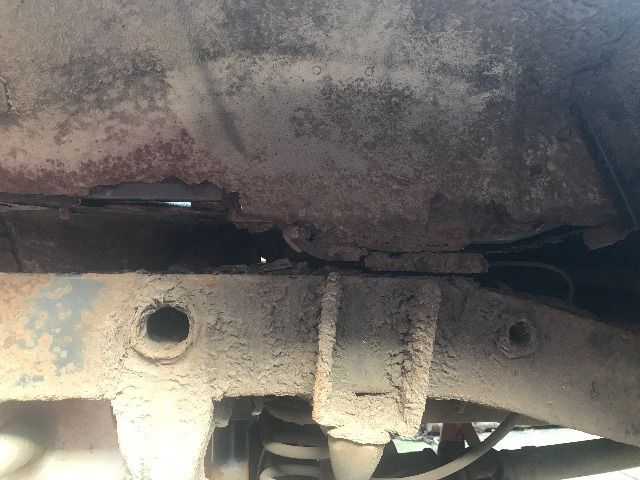

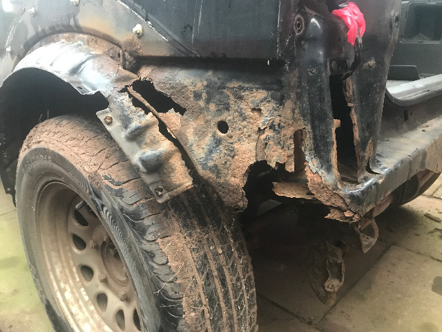

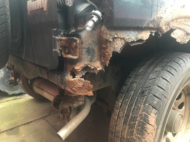

So my 01 Jimny failed its MOT last week, I knew it was a bit crunchy in the back but it wasn't untill I pulled the bumper off to see about fixing it that I realized quite how bad it was.
Both rear body mounts are completely gone, the rear corners of the body don't exist anymore. boot floor on the driver's side has come away from the wheel tub with a nice big hole the whole length of the wheelarch, inner sills below the middle body mounts have holes but the inner sills overall aren't that bad. The outer sills are pretty solid besides one hole on the passenger side. I've welded some rusty junk back together in my time, but this is like swiss cheese and it's all structural stuff in awkward spots. Seems like it'd need the body taking off the frame to properly fix some of this mess, and I lack the facilities to do that. I like my Jimny, but i'm not sure it's worth the effort.
For your entertainment, here's some pictures of the carnage:
So the obvious (and sensible) option is to just scrap it or sell it. It was daily driven before the MOT fail and hasn't got much else wrong with it, so i'm reluctant to just scrap it. The head gasket went just after I bought it, and it had a new head gasket and cylinder head put on it about 2500 miles ago, it's been bulletproof ever since. The clutch is very worn and was due for a replacement if it passed, but i'd still drive it anywhere.
I've been eyeing MOT fail and spares or repair Jimnys on ebay, I was wondering if it's realistic to buy one with a blown up engine but a decent body and drop my engine in it, but I've not been able to find any with bad engines to get an idea on the price. Wondering if anyone's got any kind of rough figures on what they go for with bad engines?
Not the most sensible option obviously, but an engine swap would be a more interesting project than trying to weld up this mess.

I'm fairly new to Jimny's but there are 100's if not 1000's of them like yours, it's a big job to get it back to a usable state again, looking at those for sale & the couple of 'mint' condition ones I looked at you have little chance of getting one of the same age in any better condition. If you have the space then breaking is probably the best way to get the most back for it. Or just an honest advert & get rid.

A lot of this depends how long you can wait without the Jimny in working order.
Its possible to find one with a blown engine, but current high prices may cause some sellers to "flog it as a good one" and pass the head issue onto the purchaser, commanding a high price as an extra insult. That said not everyone does this, if you can bide your time one will turn up.
How about a front end crash write off, no hiding that. You could "cut and shut" a repair panel, not as bad as it sounds as the Jimny body isn't monocoque.
Alternatively it's time for a tray back, remove the rotton rear end altogether.
Obviously it helps if you can at least weld, it opens up many options if you can, but if it's only spanners you have then options are limited.
How are the front body mounts under the headlamps? Based on the rears the these can't be far behind as they usually fail first. Worth checking the rest of the body to understand if welding is a viable option.
