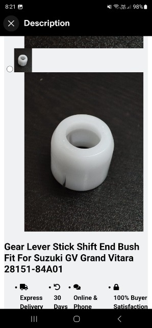

I noticed on my garage floor the white nylon lower gear shifter bush that goes on the bottom of the shifter under the car,
I put it back on but seems to kinda come loose easily,

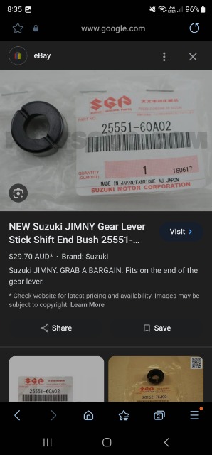

I looked up a replacement part but it's black?? Not white nylon?
Is it the same or am i missing a piece somewhere?
The white one in the picture is of the same one I have
The black one in pic is a replacement but different?

I no it's says vitara on white one but it's what's on my 06 jimny

The Vitara and the Jimny shifters are very different designs - there's no way the Vitara bush can fall out of the Vitara onto the floor, and the reason it's falling out of the Jimny just might be because it's not the right part.

Yeh possibly, I'll call suzuki and see what part number they can give me to find what part I need
