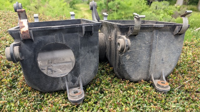

So I've drilled a 64mm hole in the air box. First impressions are it let's a lot more noise out! Hard to tell if it's improved performance, but the sound alone makes it feel sportier. I've lost my OBD dongle but when I find that I'll do some back to back 3rd gear pulls to see if it makes any difference to performance.

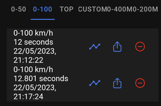

I couldn't find the dongle but I downloaded a performance app and did a couple of 0-100kmh runs. Now, this is not very scientific as it's just an app using phone GPS and I took it fairly easy on the start, but the results do correlate with how it feels. 12 seconds with the hole open, 12.8 second with it taped up. I'd say that's significant and worthwhile improvement for a 5 minute modification!
Bear in mind my Jimny has a 1.6 and they always feel a bit strangled at higher rpm compared to the revvy 1.3. Drilling this hole seems to have fixed that.

I still stand by my humble opinion for a Standard Jimny, it's not going to do much.
The air filter system on the Jimny is designed for a 1.3 N/A engine, the air filter system designed by Suzuki for the 1.6 is different.
What you have is a 1.6 with a Jimny 1.3 air filter system, it's likely it will impede the air flow for the 1.6. I wouldn't want the original poster to believe it's instantly going to give more performance.
