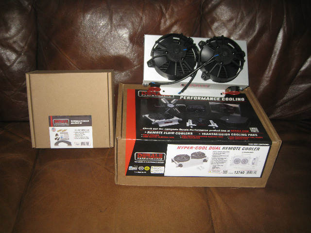

I purchased this one from Derale:
Anyone buying this type might have a challenge finding a location. In honesty I didn't pursue it very long since it fit inside my front bumper.....almost like it was made for it.

I live in a hot climate 24/7 year round so I fitted a fairly large one. Made a bracket out of an old metal chair frame and reused the threaded holes on the jimny front bar
