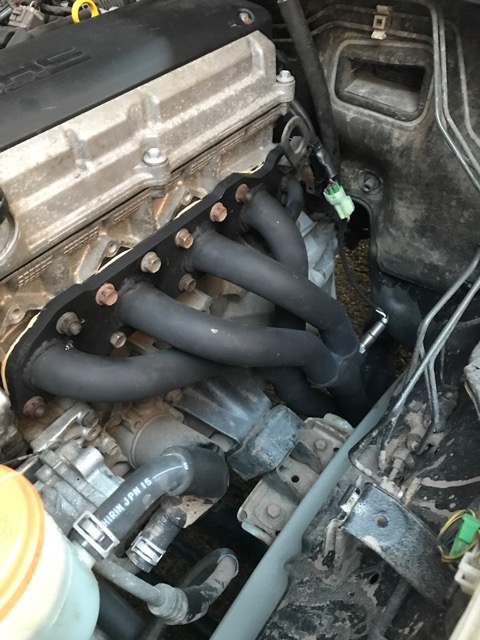

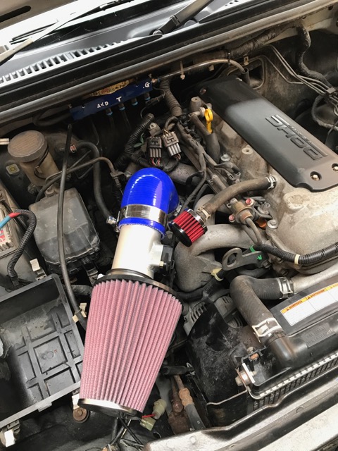

Conventional tuning on the Jimny works relatively well but it's more expensive to tune the 1300 than it is to change to a 1600.....
4-2-1 exhaust manifold with a 2" sports cat, single box system with a K&N panel filter worked pretty well on the 1300, more torque was available sooner, making driving more pleasent. Fewer gearchanges, holding 30mph in 4th uphill, just generally easier..... but you could of had an engine swap for the cost.....
