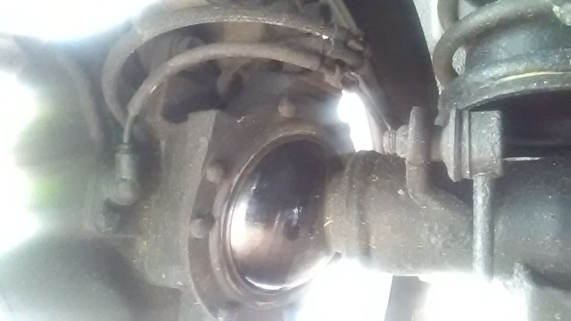

09 Jun 2020 08:07 #223400
by Scimike
Replied by Scimike on topic Swivel Seals: Stock or Trail Gear
Yep it was me, I've got shinny balls.:whistle:
POR 15 is good stuff but you need to degrease well and apply several thin coats, sanding with 400 grit between coats. This "fills in" any deep rust pitting and the final 2 coats are the finish. The good news is it drys fast with humidity. Keep the paint in your fridge once opened and keep the lid clean or you will never get it off again.
Here is a picture of my swivel taken this morning, it's still good, no rust, no leaks and it's over a year now of daily use since I did them.
It's good stuff if applied correctly.
Worth doing in my opinion.
