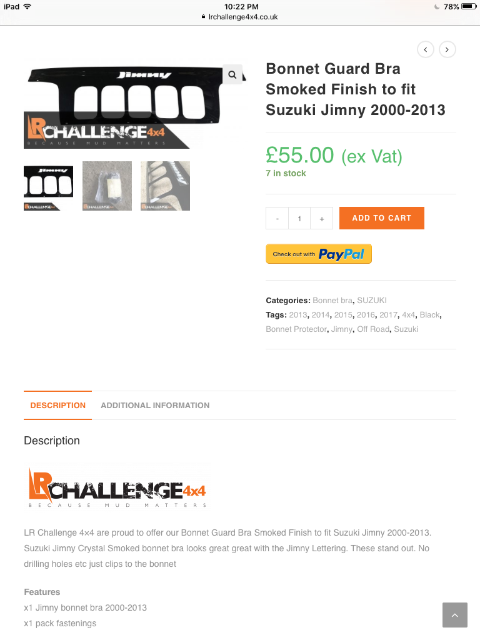

I have a 98 & a 99 hard top & soft top. Both LHD.
I want to fit a bonnet guard to the 1998 tin top.
But...
The website states it's only for 2000-2013 models. What's the difference between the 98-99 and the 2000+ ?
Anyone tried fitting one on a 98 or 99 ?

The picture is showing what i think is the early model. Should fit 1998 to 2013 as there is no difference between those except the (lower part of the) front bumper from 2009-ish (markets variations).
1998 to 2013 (and then some in some markets) the grille is included in the bonnet.
2013-2018 (variations within markets) the grille is stand alone, the bonnet stops on top of the grille and is taller in front due to the taller fenders/wings

Thanks for that.
I think for £55 I'm going to risk it.
I can't see why it won't fit.
If it does, I'll let everyone know.

No difference, other than centre badge changed around 2006. Then 2012-13 different bonnet
