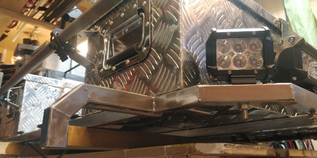

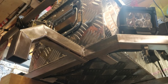

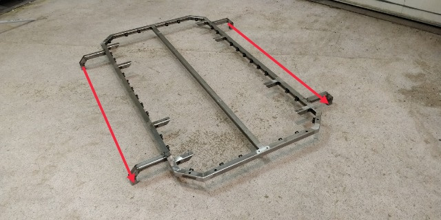

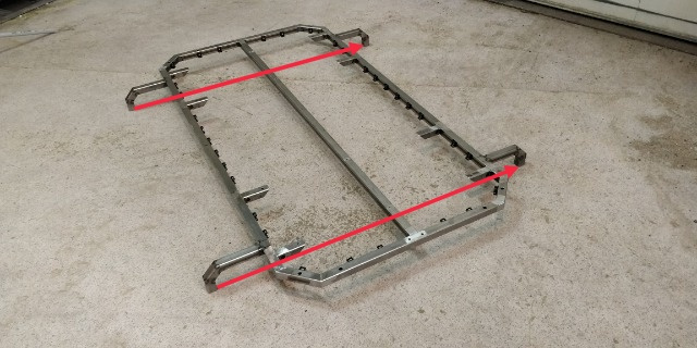

Because at the minute your legs are unsupported laterally from the inside and with sufficient dynamic load will twist the side bars and cause a fatigue failure. It needs cross bars between the legs at the main hoop level so that the legs are continuous over the width.

@Lambert
I would rather reinforce, than add two crossbars.
Keep in mind that the boxes are a part of the supporting? (do not know if it's the right word) construction.
The boxes are bolted to the frame with 6 pcs of M6 each.
The frame is built with 25x25x2 steel. And I have reinforced the four legs with pieces of 15x5mm steel.
