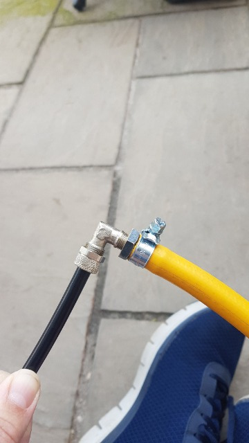

Thanks everyone, tomorrow im fitting the ARB breathers and fitting soeleys hand made step down pipe components.
