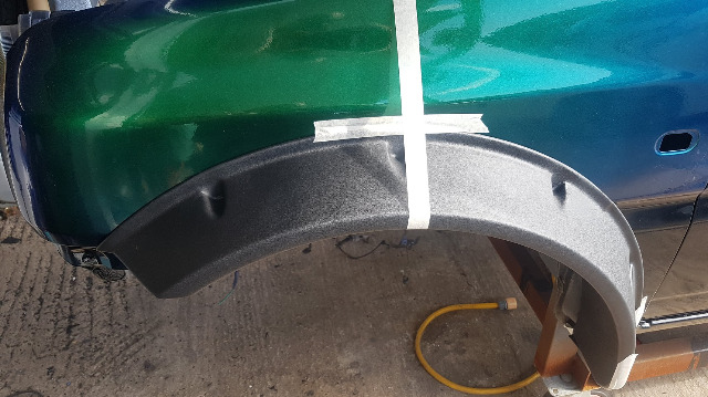

Hi there just brought a set of insa turbo special tracks and might need to cut the fenders and was wandering what’s the best way to do it and how do u re attach the wheel arch liner once u have cut them thanks

I would suggest that it is going to be a fairly custom process and you will need to make it up as you go along, taking the minimum amount in little sections at a time. It will probably be easier to support the car on the chassis and remove the road springs to obtain maximum compression more safely and just see what keeps catching. How big are the tyres?

Never seen the arch liners re-attached as the part they go to is the part trimmed off.
The vertical seam on the front bulkhead needs to be folded out of the way at the lower portion.
